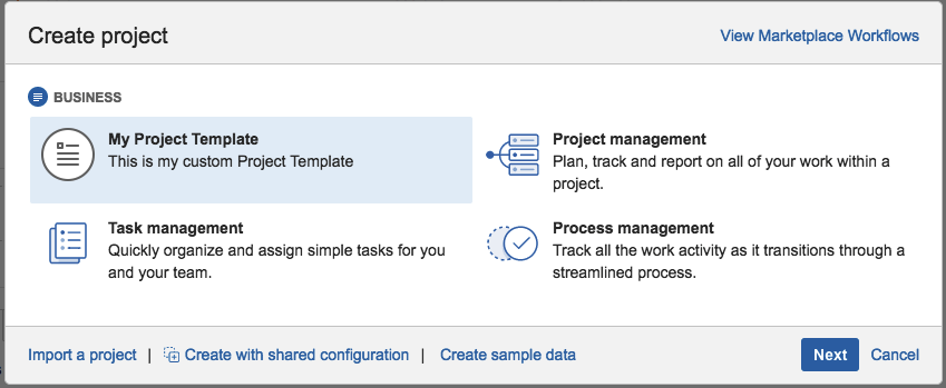

  3. Find the Jira home page URL in the Terminal output and open it in your browser.
  4. Log in with the default admin/admin.

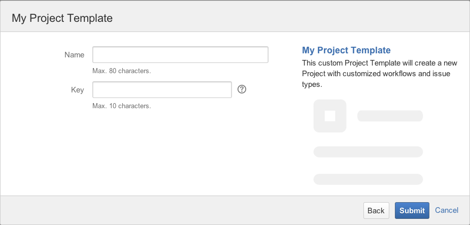

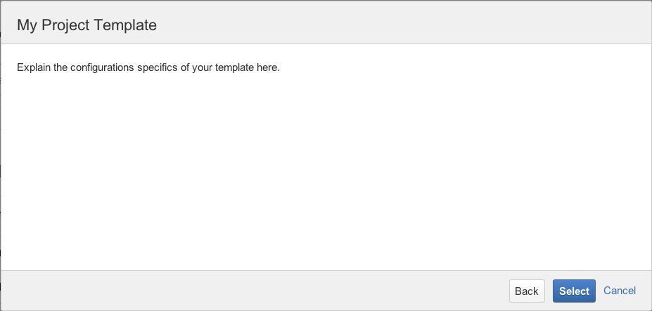

  5. Create a new project based on the My Project Template template. This is the template you created.
  6. Check that the information page is shown.
  7. Enter a project name and a key, as usual.
  8. Click Submit. Confirm that you are redirected to the issue browser page.
