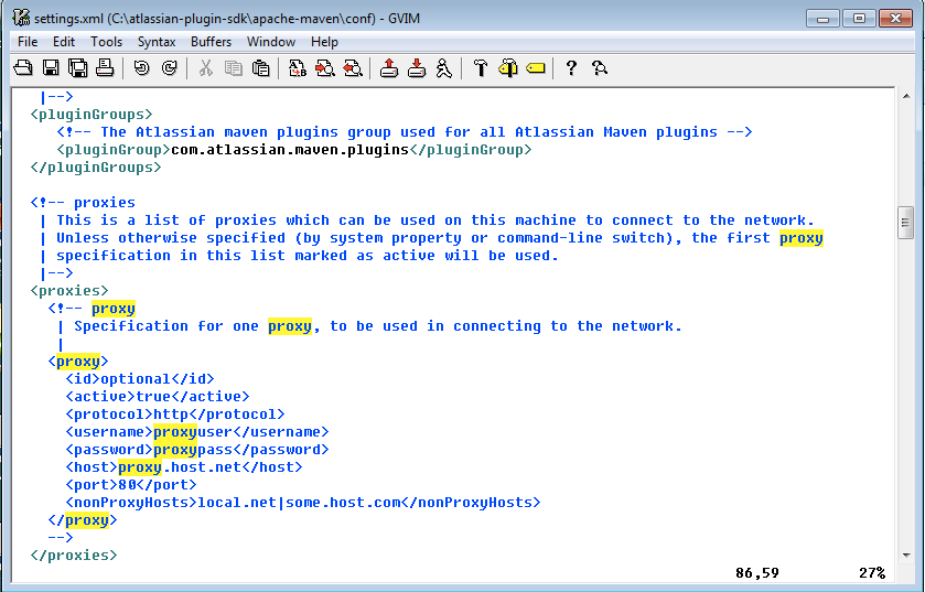

  2. Edit the ATLAS_HOME/apache-maven/conf/settings.xml file in your favorite editor.
  3. Locate the <proxies> section.
  4. Uncomment the proxy element.
  5. Edit the proxy element and add the values provided by your system administrator.
    When you are done, the element looks similar to the following:

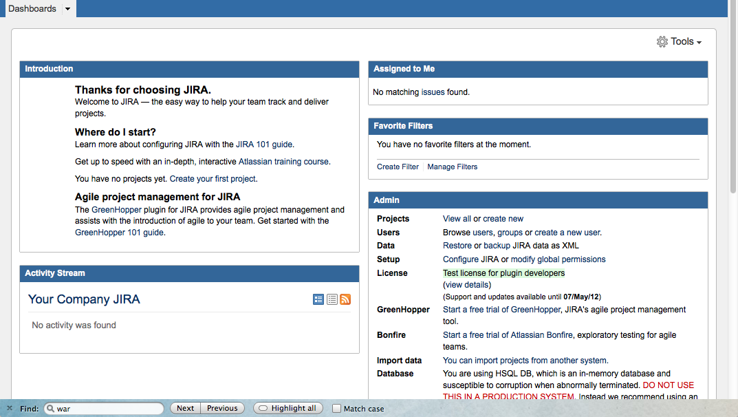

  5. Open a browser and enter the JIRA URL.
    You should see the URL for your installation displayed in the run output. For example, you might see myhost.local:2990/jira or localhost:2990/jira depending on your environment. On successful launch, the browser displays the JIRA login page.
  6. Enter admin for both the username and password.
    Your browser displays the JIRA dashboard:
    You'll notice in the Admin section the License that you are running is a Test license for plugin developers.

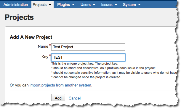

  3. Name your project Test Project and give it a key of TEST.
    When you are done, the dialog looks similar to the following:
  4. Click Add to add the project.
