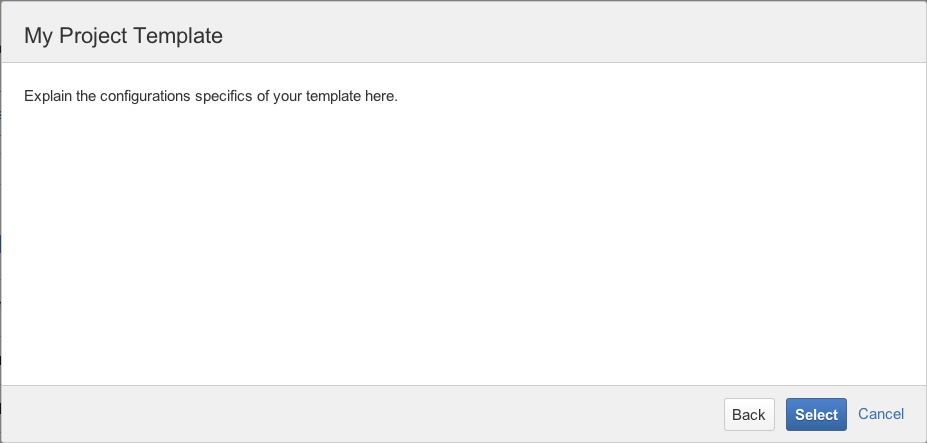

    We will use this template for project info page.

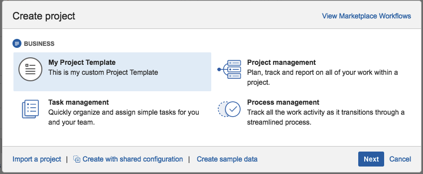

  5. Create a new project based on the My Project Template template. This is the template you created.
  6. Check that the information page is shown.

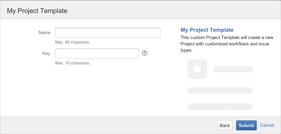

  7. Enter a project name and a key, as usual.
  8. Click Submit. Confirm that you are redirected to the issue browser page.
