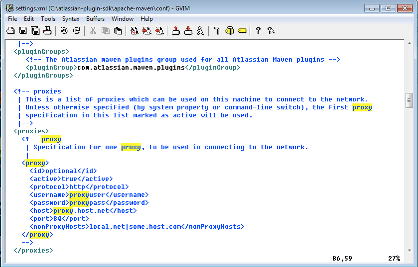

If you're doing your development behind a corporate firewall, you may need to connect to the Internet through an HTTP proxy. If you know you do not have a firewall, skip this procedure. If you know your company requires you to use an HTTP proxy, you need to configure proxy settings in the ATLAS_HOME/apache-maven/conf/settings.xml file. Do the following:
  1. Ask your system administrator to provide you with the following information:
  2. Edit the ATLAS_HOME/apache-maven/conf/settings.xml file in your favorite editor.
  3. Locate the <proxies> section.
  4. Uncomment the proxy element.
  5. Edit the proxy element and add the values provided by your system administrator.
    When you are done, the element looks similar to the following:

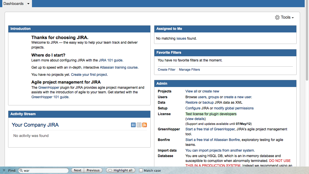

  5. Open a browser and enter the JIRA URL.
    You should see the URL for your installation displayed in the run output. For example, you might see myhost.local:2990/jira or localhost:2990/jira depending on your environment. On successful launch, the browser displays the JIRA login page.
  6. Enter admin for both the username and password.
    Your browser displays the JIRA dashboard:
    You'll notice in the Admin section the License that you are running is a Test license for plugin developers.

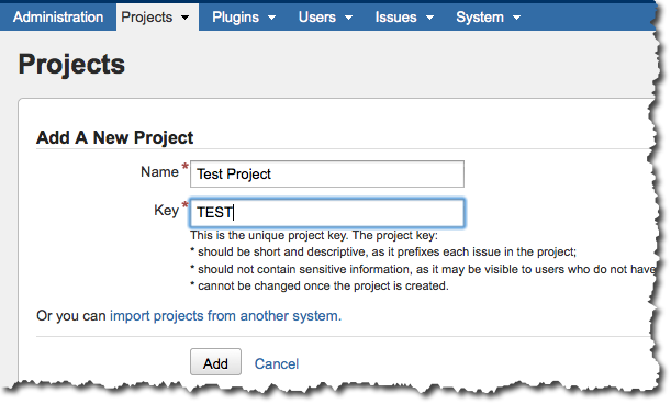

  2. Choose the create new link from the Projects section.
    The system opens the Create New Project page.
  3. Name your project Test Project and give it a key of TEST.
    When you are done, the dialog looks similar to the following:
  4. Click Add to add the project.
    Your standalone JIRA now has a TEST project. Test what happens to the project when you restart this standalone instance.
