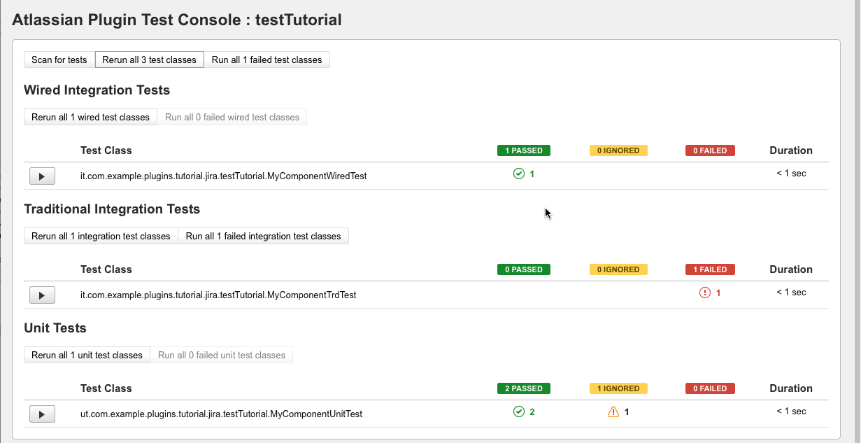

  3. Click Toolbox > Plugin Test Console.
    The test console appears. The console lists the type of tests it found in your project.
  4. Press Rerun all 3 test classes to run your tests and display their results:
or
  1. Copy and paste the URL into your browser's address field along with /plugins/servlet/it-test-console at the end of the URL (e.g. http://localhost:2990/jira/plugins/servlet/it-test-console).
  2. The browser displays the host application, in the case of this tutorial, JIRA.
  3. Enter admin for both the User and the Password.
  4. The test console appears. The console lists the type of tests it found in your project.
  5. Press Rerun all 3 test classes to run your tests and display their results
