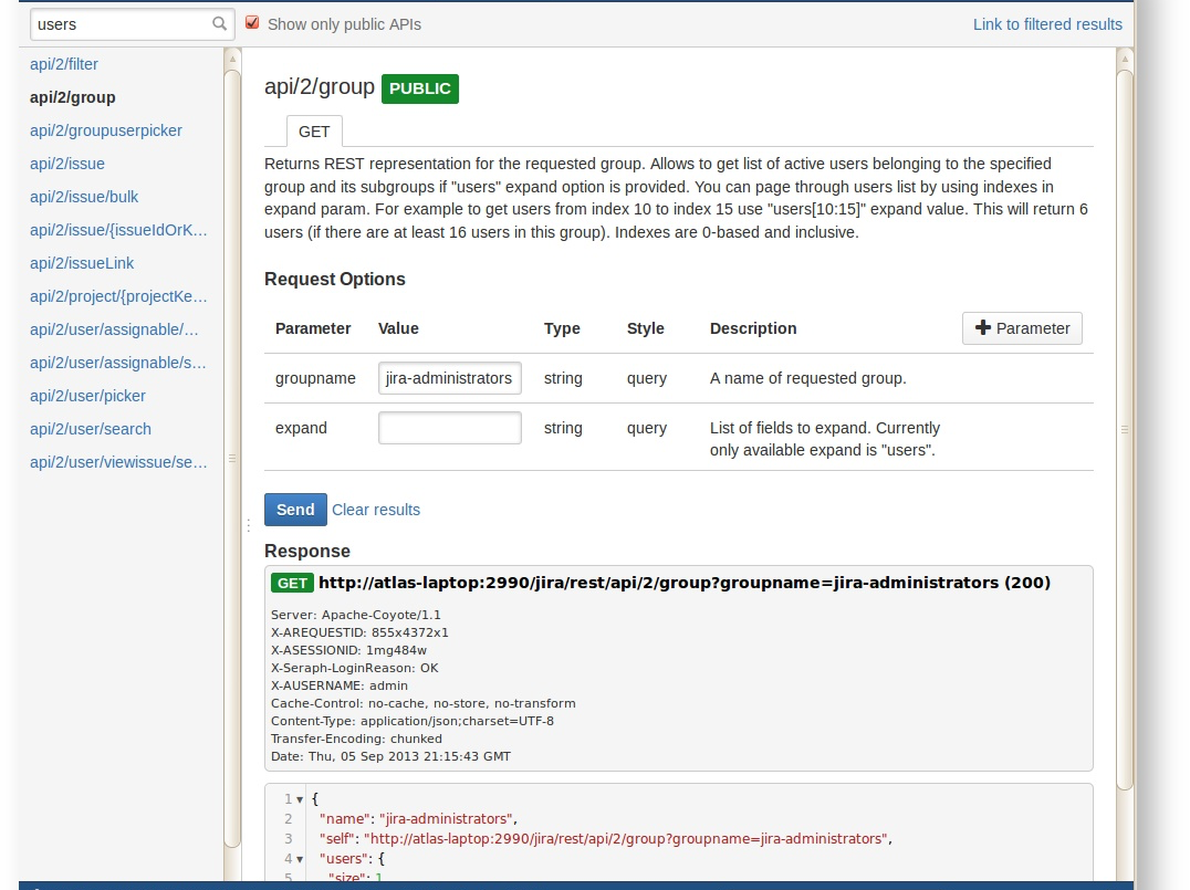

  4. Choose a resource from the left menu. You can either browse through the list, or enter text in the Search field to filter the resources that are shown.
    The resource page appears. Notice that the RAB displays the HTTP methods (GET, POST, PUT, and so on) applicable to each resource as tabs at the top of the page. It also contains fields for any parameters accepted by the resource.
    After entering a search term, you can use the Link to filtered results to save or share a link to the filtered results.
  5. To test a resource, enter any required parameter values in the fields and click Send.
    The results appear in the Response section of the page, as shown by the following screenshot.
