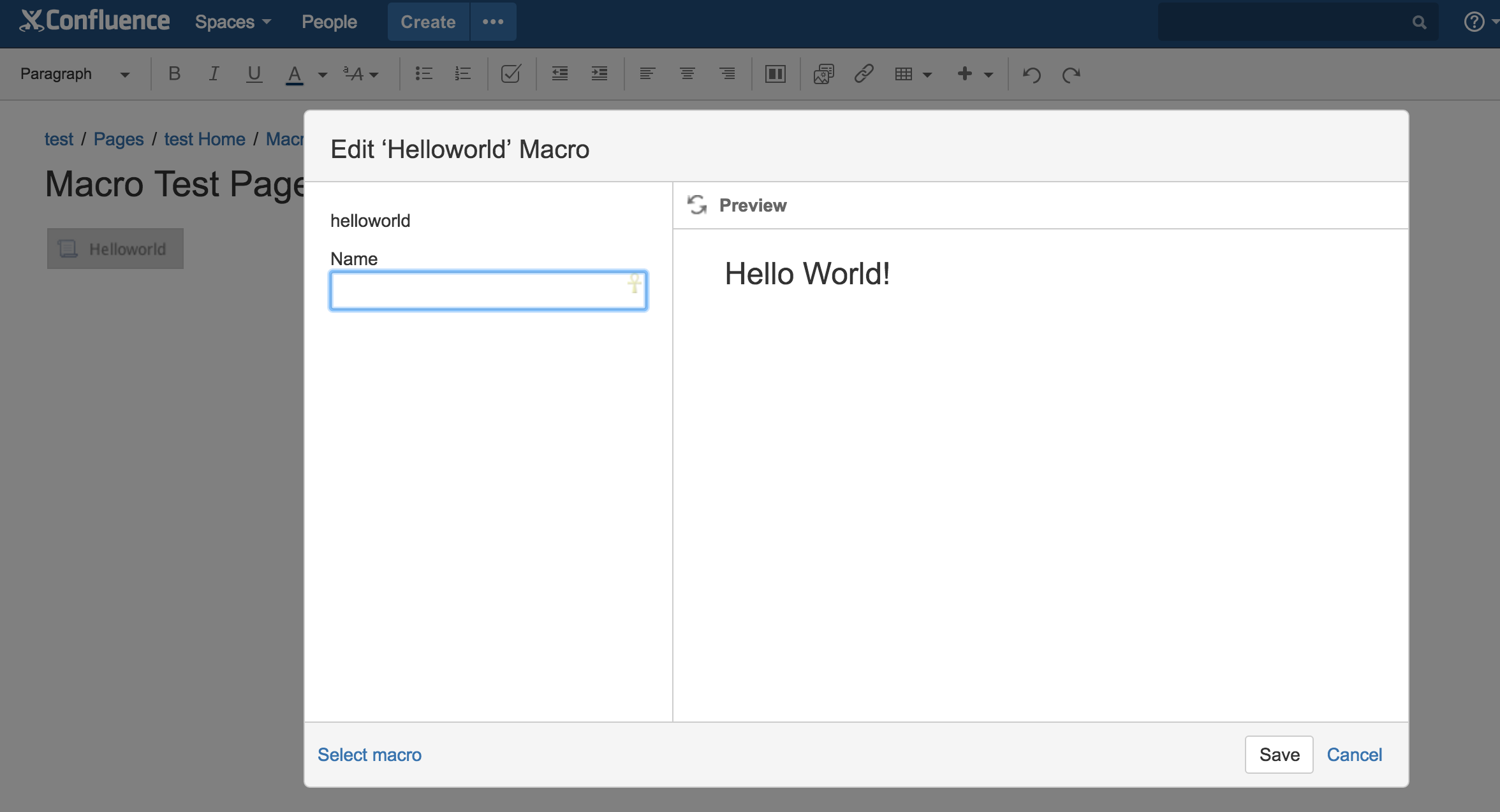

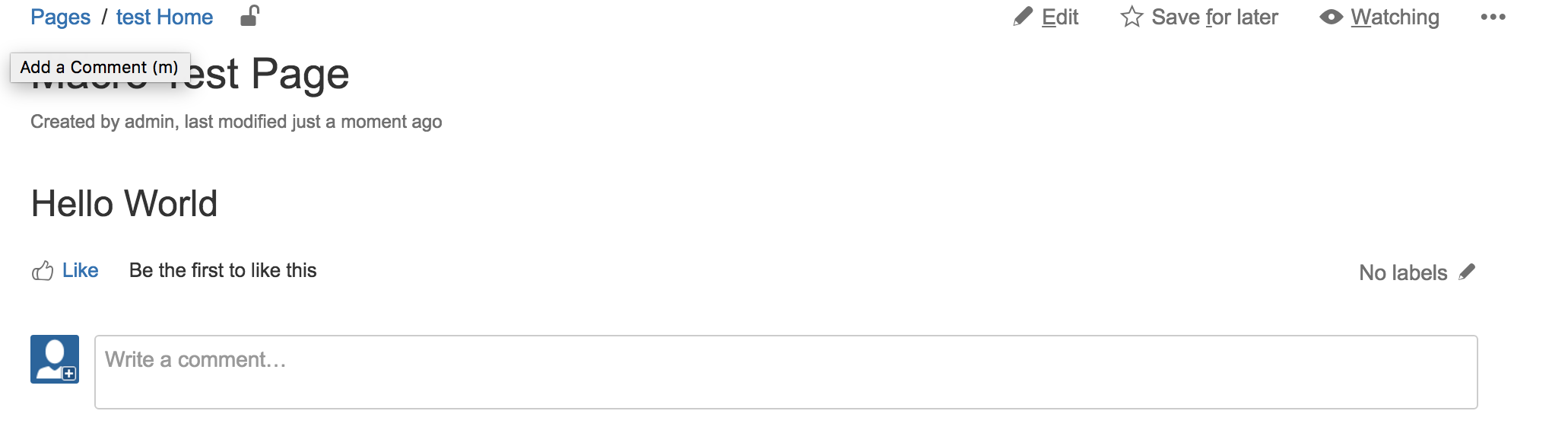

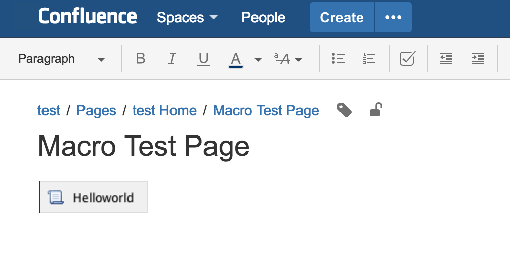

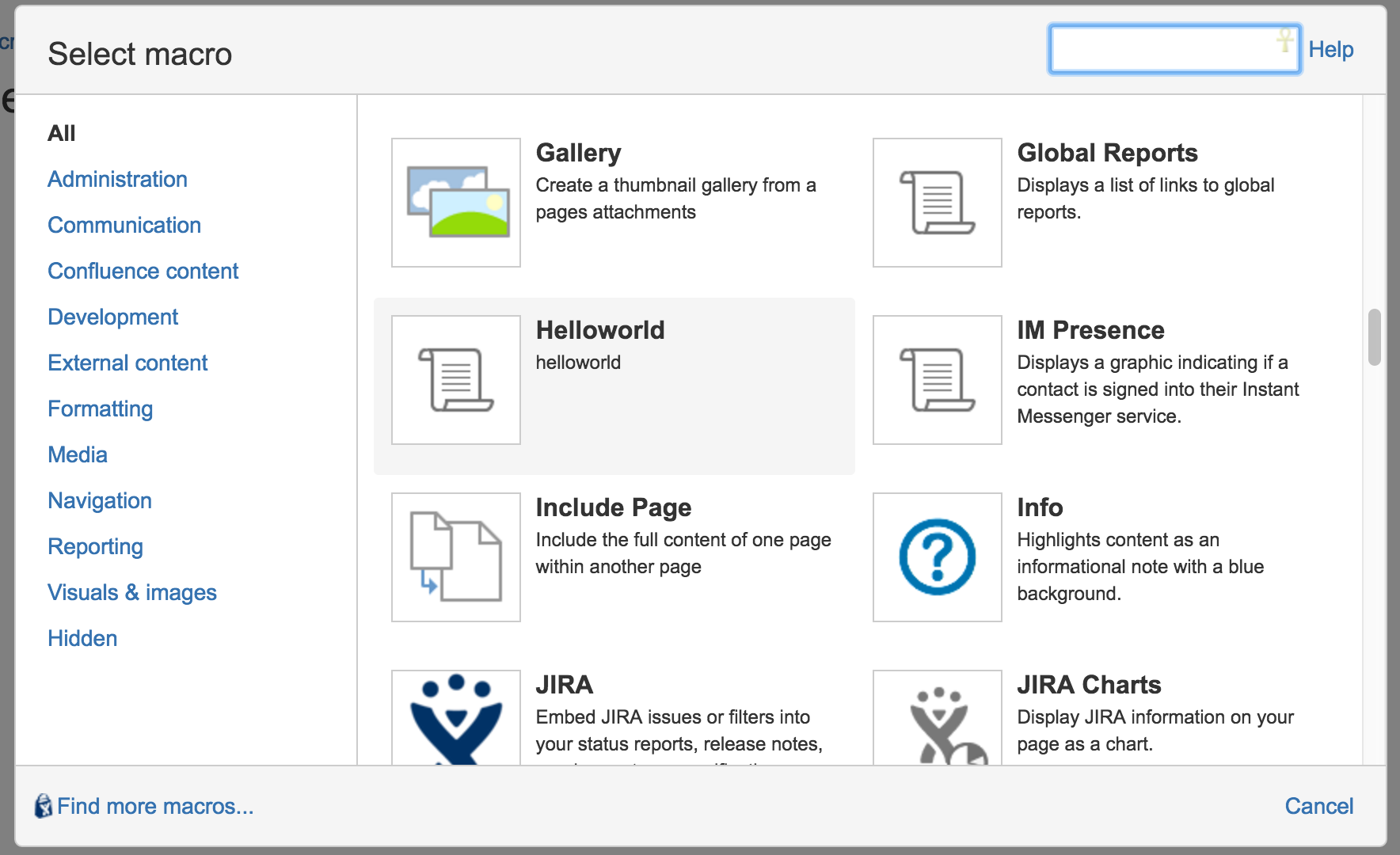

  11. Now you can try adding the Macro to a test page in Confluence (you'll need to make a new Confluence Space and Page before you can test it out so go ahead and do that first).
Note
Note: It can take the Confluence macro browser a little bit of time to realise that there's a new macro available, so if it doesn't show up right away give it a little while and try again.
Confluence macro browser showing helloworld macro Helloworld macro showing on confluence page in edit mode Helloworld Macro shown on Confluence page that has been saved

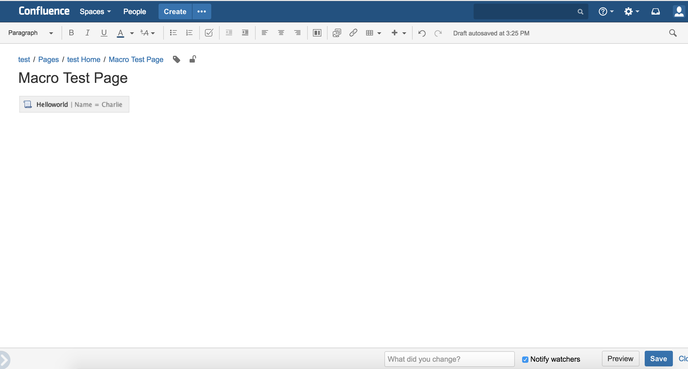

Now, you will allow the user to specify their name using a parameter to learn about how parameters can be set, and used.
  1. Open the **atlassian-plugin.xml **file in your favourite editor.
  2. Locate the <parameters/> element within the <xhtml-macro> element you created in the first part of this tutorial.
  3. Replace the <parameters/> element with the following:
    1
    2
    3
    4
    <parameters>
        <parameter name="Name" type="string" />
    </parameters>
    This specifies that the parameter is called 'Name' and is of type 'string'.  You can find the full list of types under the Parameters heading in the macro module documentation
  4. Save and close the changes you made to atlassian-plugin.xml

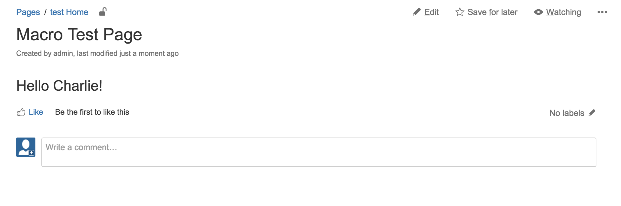

  9. Monitor the terminal window where Confluence is running to confirm that the plugin has been reloaded by QuickReload.
  10. Log in and check your changes are working:

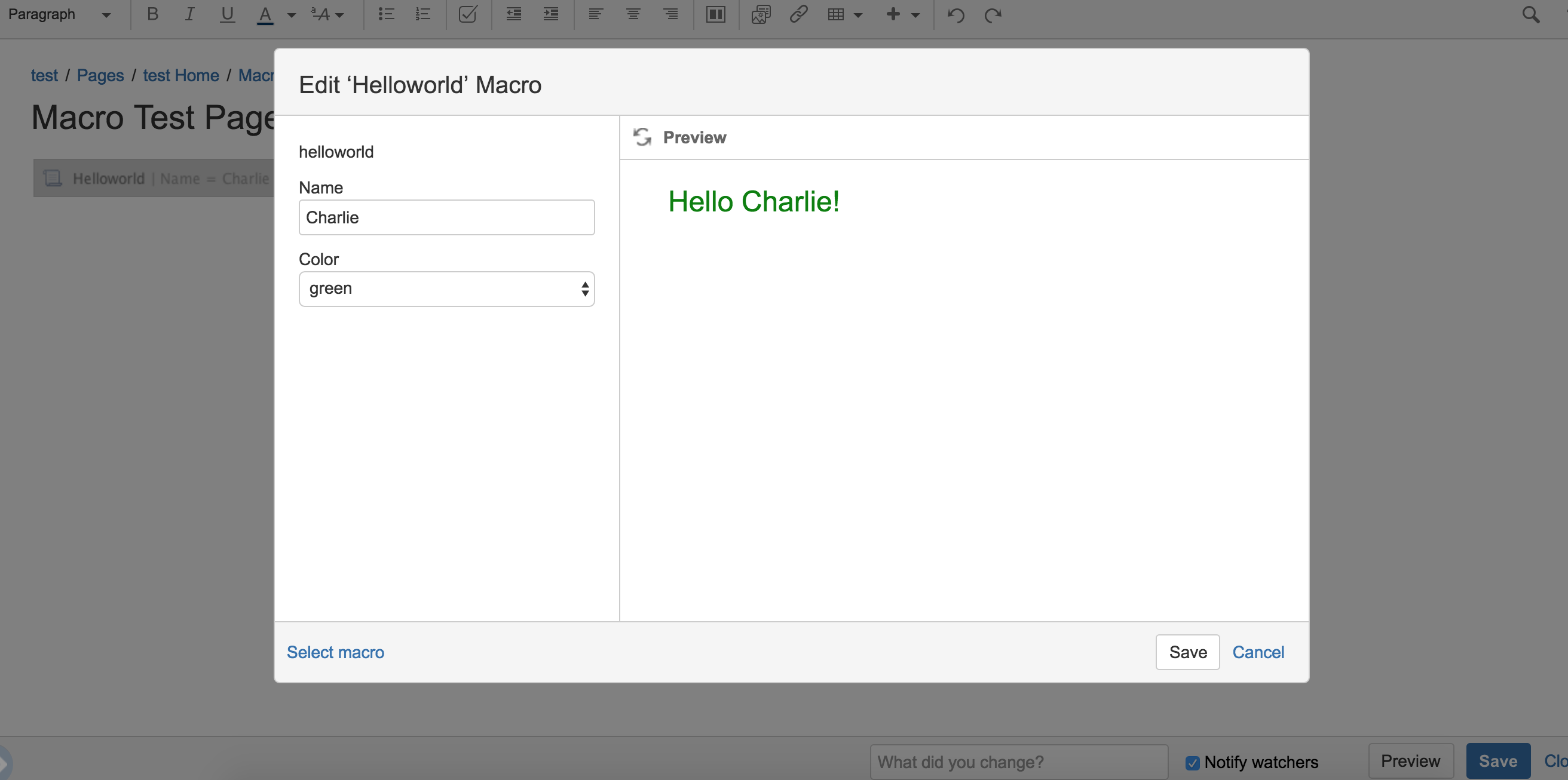

  3. Below your <parameter name="Name" type="string" />, add a new <parameter name="Color" type="enum"> as follows:
    1
    2
    3
    4
    5
    6
        <value name="red"/>
        <value name="green"/>
        <value name="blue"/>
    </parameter>
    This will create a drop down menu in the macro editor for the user to select their color as either red, green or blue.

  15. Make sure your plugin is working with the new changes:
Note
You might need to hold down the shift key while reloading the page to see the changes to the page itself!
