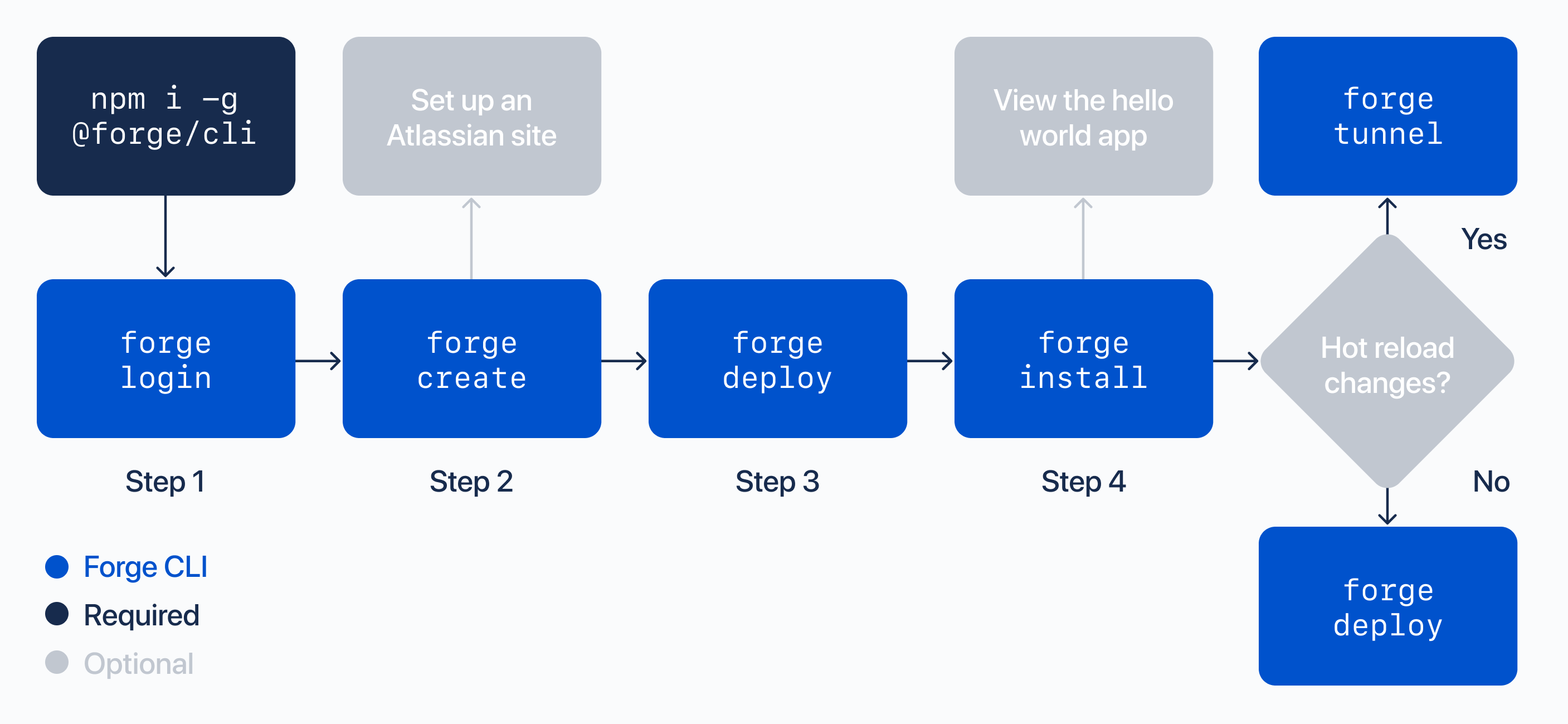

Hello world CLI overview
After installing the Forge CLI, follow the prompts in the terminal to build a hello world app. For a complete explanation of each step, continue reading along with the documentation.
