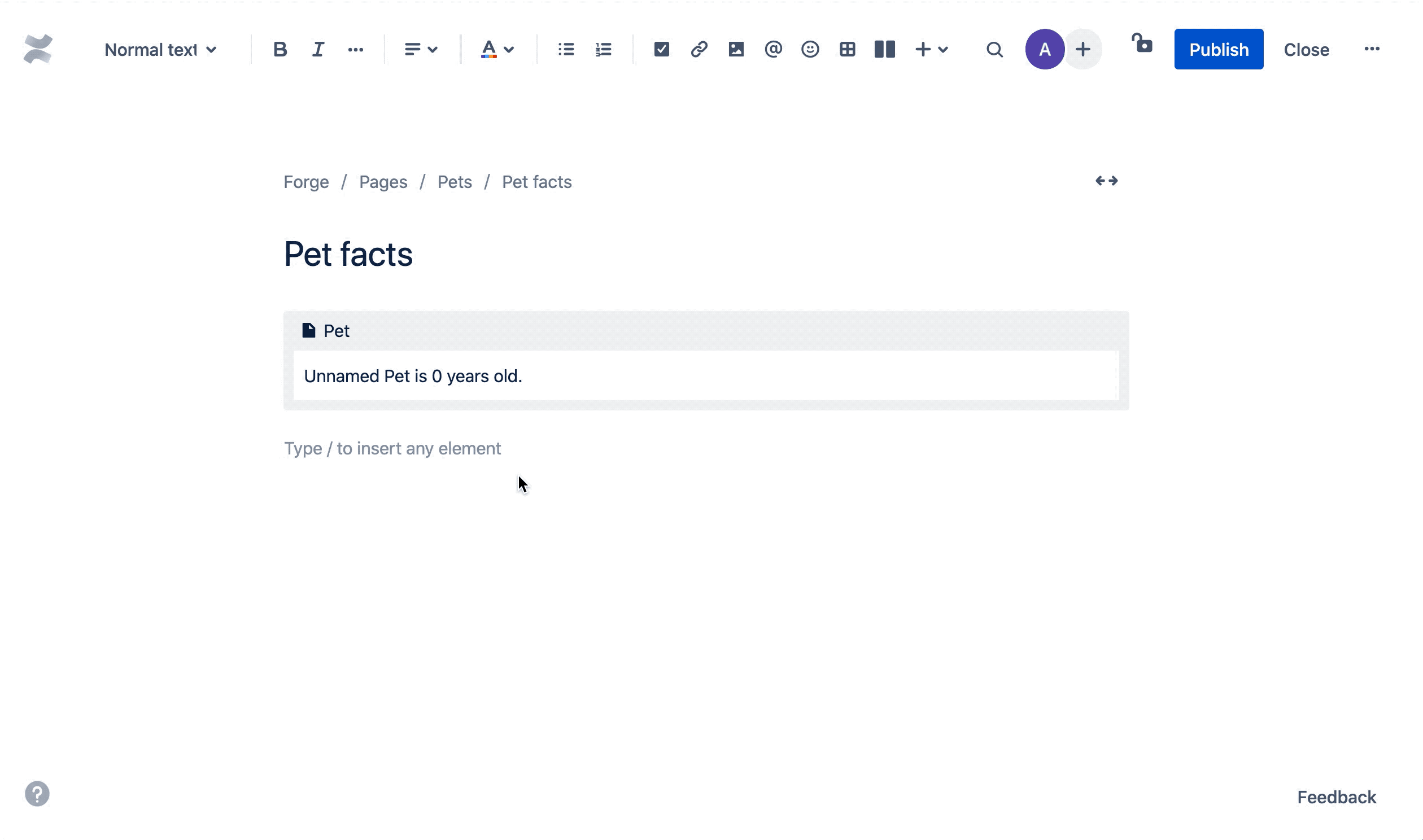

Macro configuration enables users to customize what displays in a macro by setting values in a form. To add configuration to a Confluence macro that doesn't have any configuration yet, see Add configuration to a macro.
The new macro configuration consists of form fields displayed in a side panel, letting users customize what displays in the macro, while seeing the macro update in real time, as shown below.
Example of configuring a Forge macro
