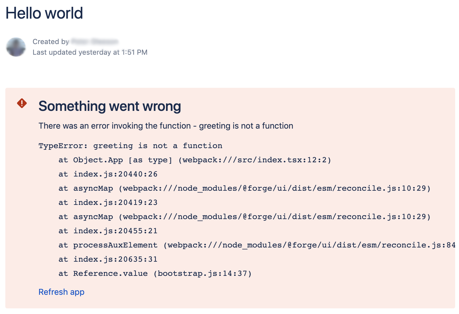

Runtime errors: Returned for general runtime errors. For example, calling a method that does not exist or is not a method. These errors are shown in the app UI. A stack trace is included with the error message. For example: Runtime error example
