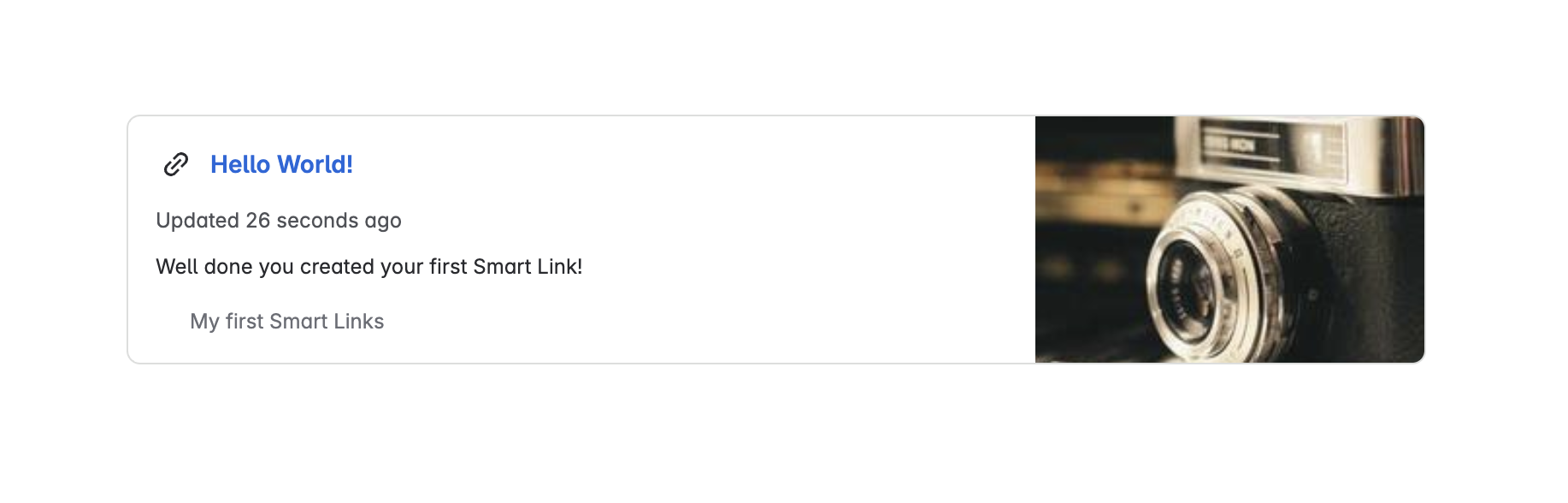

Test the app
To test the app, open up Jira, create an Jira issue, and paste https://www.my-first-smartlink.com/12346 into the description. If your setup is correct, your Smart Link will appear; otherwise, it will display as a regular link.
These links can now be added to any Smart Link-enabled surface such as Jira issues, Confluence pages, Confluence whiteboards, and more.
