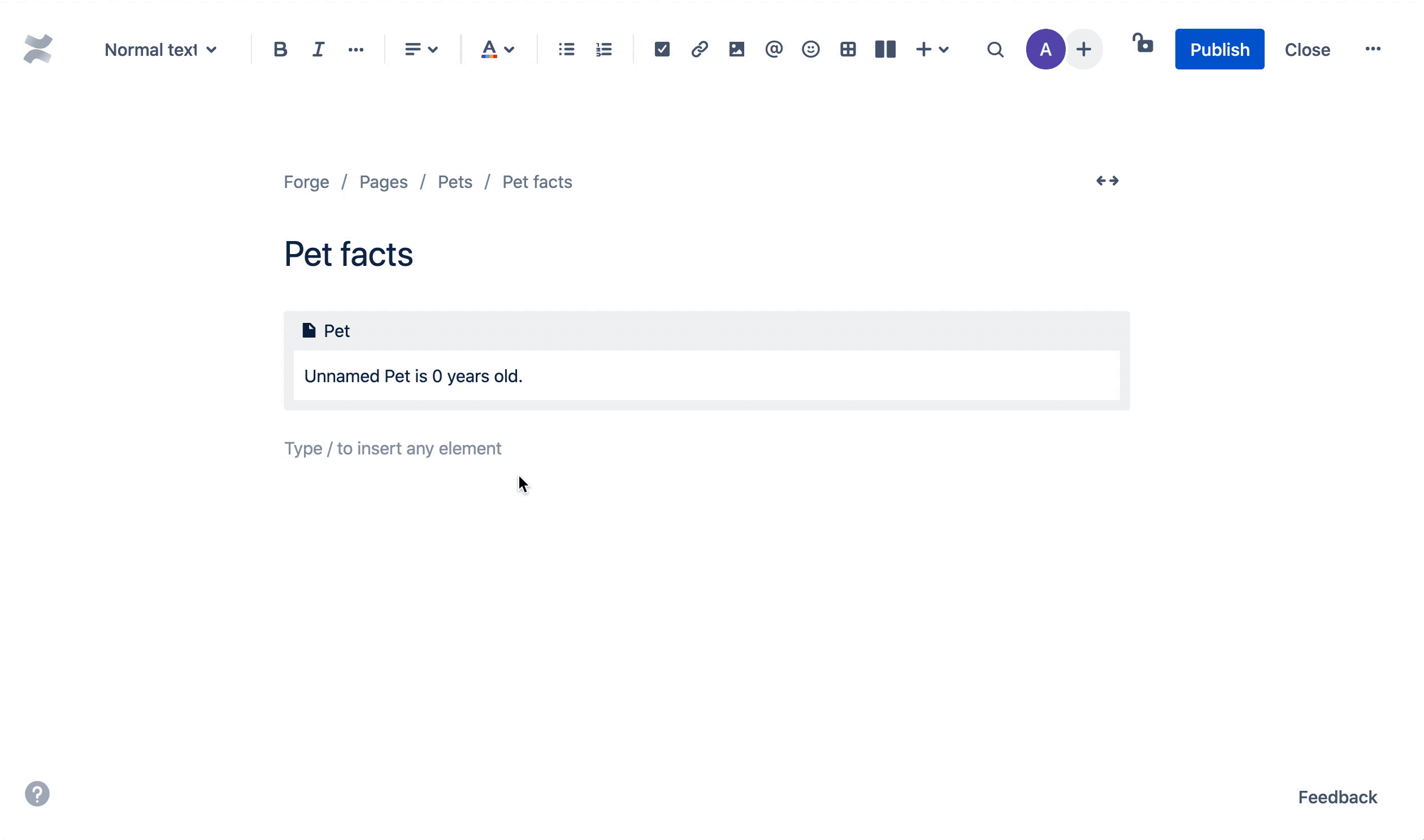

View your app
  1. Edit a Confluence page in your development site.
  2. Select Insert icon from the toolbar from the toolbar.
  3. Find the macro by name and select it. The app is displayed on the page.
  4. Click the pencil icon to open the app's config panel on the right side of the page.
  5. Type the Pet age, Pet name, and then close the configuration page. The config values are saved automatically.
You should now see the config values displayed within the app.
