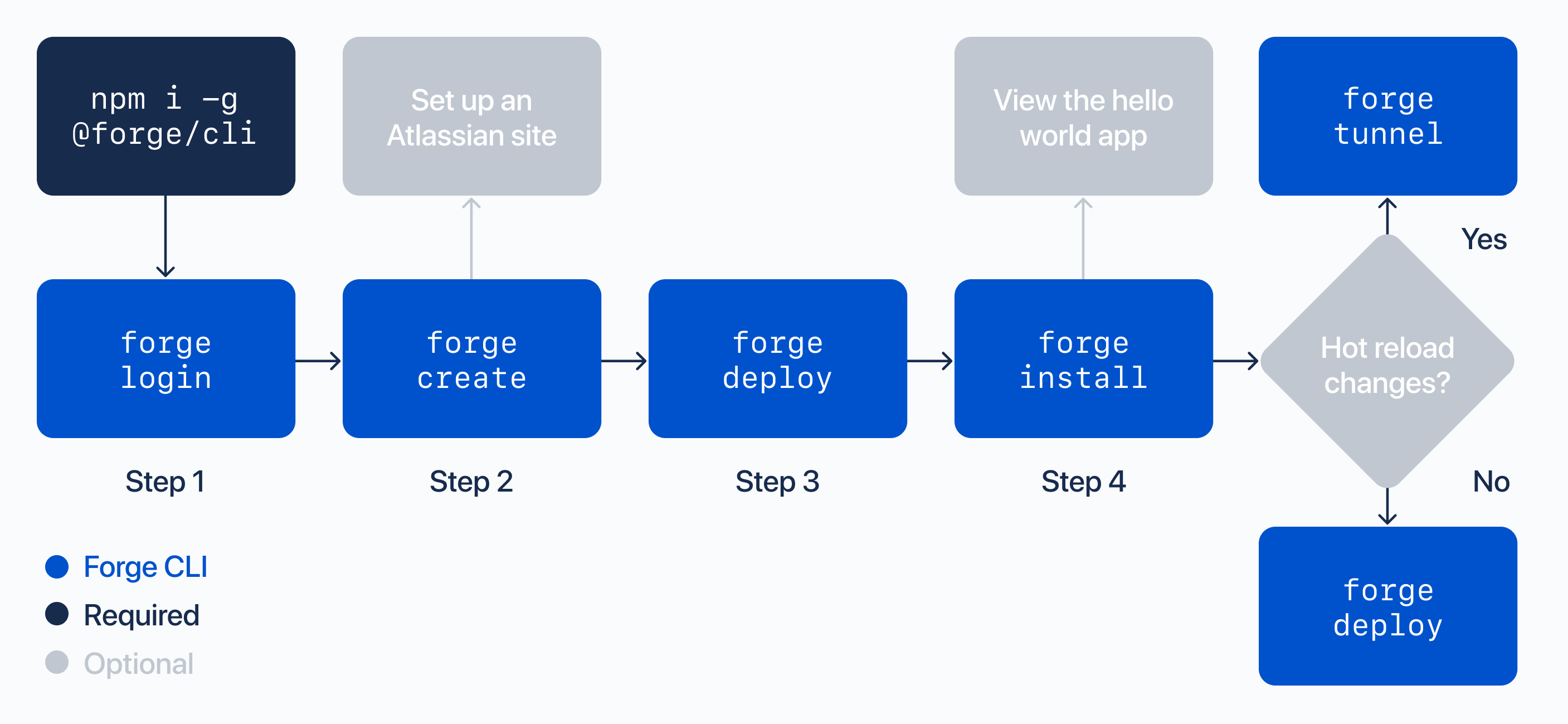

Install the Forge CLI using npm. You'll install the CLI globally so that the commands can be run across your system.
Do not install forge with root privileges. In case that has been done, you might need to uninstall forge.
This can be done using the command in mac (or similar in other OS)
1 2sudo rm -rf ~/Library/Preferences/@forge
Install the Forge CLI globally by running:
1 2npm install -g @forge/cli
Verify that the CLI is installed correctly by running:
1 2forge --version
You should see a version number reported in the terminal. If a version number is not shown, then the installation failed. Repeat step 1 and look for errors reported in the terminal.
With the CLI installed, view the complete list of Forge commands by running forge --help.
Installation fails with Error: spawn ts-node ENOENT? This usually means
Node.js is configured to run in development mode, which causes npm to skip
installing some dependencies the Forge CLI needs. Clear the NODE_ENV
environment variable and reinstall.
On macOS or Linux:
1 2 3unset NODE_ENV npm install -g @forge/cli
On Windows:
1 2 3set NODE_ENV= npm install -g @forge/cli
After installing the Forge CLI, follow the prompts in the terminal, or use the steps outlined below to build a hello world app.
Log in with your Atlassian account and API token. Token generation instructions below.
1 2forge login
Create a new Forge app from a template, or follow one of the detailed tutorials for a guided walkthrough.
1 2forge create
Deploy your app code to Forge.
1 2 3cd <your-app-dir> forge deploy
Error: Command failed due to validation error? You're running the
command outside a Forge project directory. This commonly happens right
after forge create, when you forget to change into the new project
directory. Run cd <your-app-dir> before running any other Forge
commands.
Install the app to an Atlassian site. You can now view and test your app.
You can install to a Forge demo development site. The CLI reuses your active demo site, or offers to provision one if you don't have one yet:
1 2forge install --demo-site
A demo site includes realistic seeded data and is active for 90 days by default. For details, see Provision a demo development site.
To use an existing Atlassian site instead, run:
1 2forge install
If you need a traditional development site, create one at Atlassian cloud developer site, then log in and complete its setup wizard.
Run a local tunnel for hot reload and log streams while developing.
1 2forge tunnel
