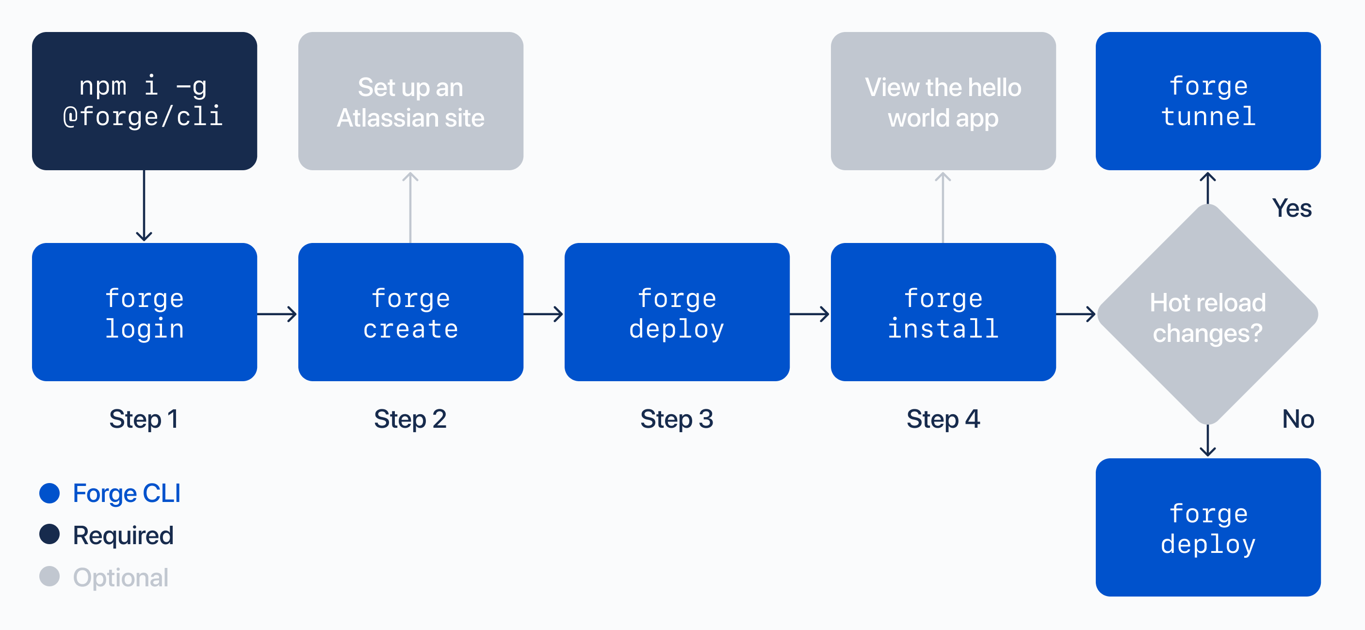

Build your first Forge app
After installing the Forge CLI, follow the prompts in the terminal, or use the steps outlined below to build a hello world app.
  1. Log in with your Atlassian account and API token. Token generation instructions below.
    1
    2
    forge login
  2. Create a new Forge app from a template, or follow one of the detailed tutorials for a guided walkthrough.
    1
    2
    forge create
  3. Deploy your app code to Forge.
    1
    2
    3
    cd <your-app-dir>
    forge deploy
    Error: Command failed due to validation error? You're running the command outside a Forge project directory. This commonly happens right after forge create, when you forget to change into the new project directory. Run cd <your-app-dir> before running any other Forge commands.
  4. Install the app to an Atlassian site. You can now view and test your app.
    You can install to a Forge demo development site. The CLI reuses your active demo site, or offers to provision one if you don't have one yet:
    1
    2
    forge install --demo-site
    A demo site includes realistic seeded data and is active for 90 days by default. For details, see Provision a demo development site.
    To use an existing Atlassian site instead, run:
    1
    2
    forge install
    If you need a traditional development site, create one at Atlassian cloud developer site, then log in and complete its setup wizard.
  5. Run a local tunnel for hot reload and log streams while developing.
    1
    2
    forge tunnel
