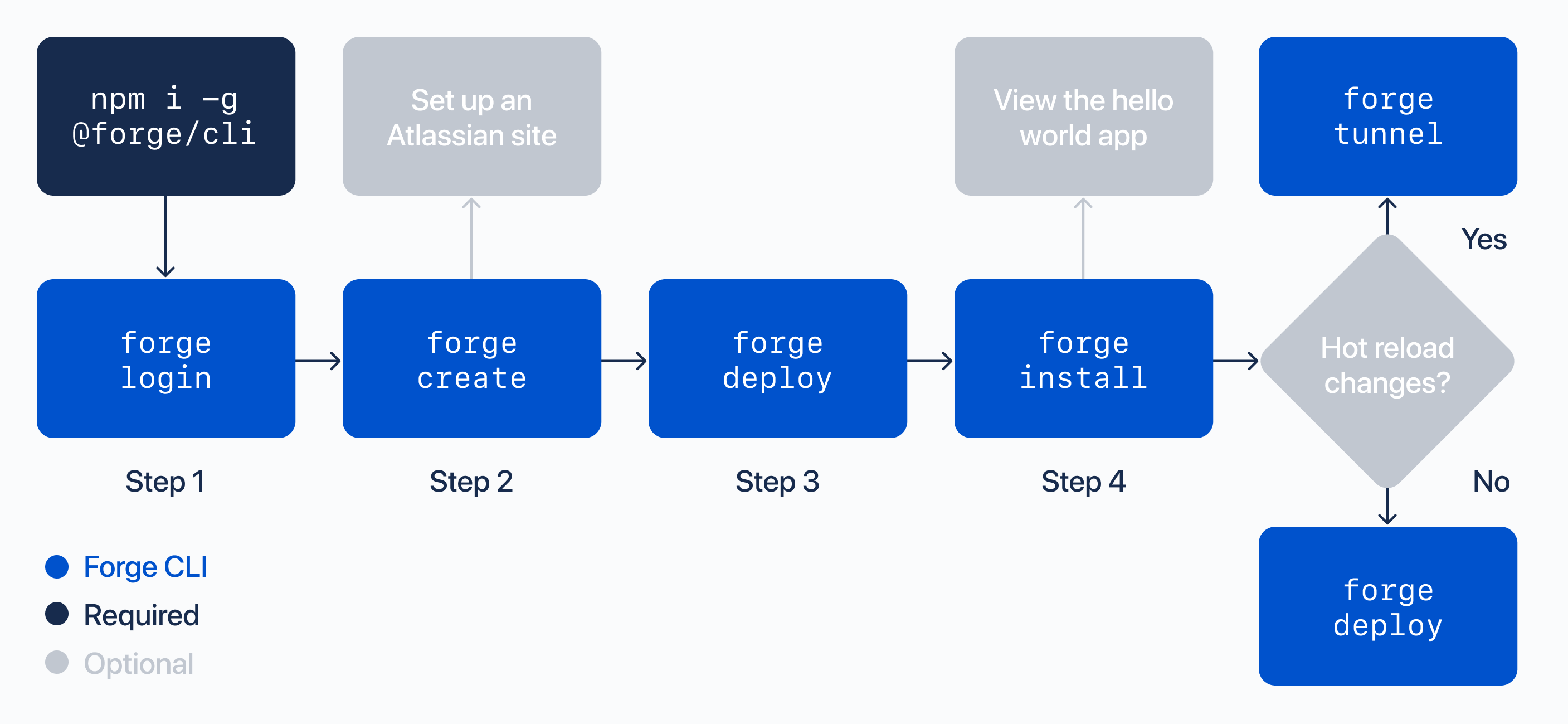

Hello world CLI overview
After installing the Forge CLI, follow the prompts in the terminal to build a hello world app. For a complete explanation of each step, continue reading along with the documentation.
Install the Forge CLI
Install the Forge CLI using npm. You’ll install the CLI globally so that the commands can be run across your system.
Do not install forge with root privileges. In case that has been done, you might need to uninstall forge. This can be done using the command in mac (or similar in other OS)
1
2
sudo rm -rf ~/Library/Preferences/@forge
  1. Install the Forge CLI globally by running:
    1
    2
    npm install -g @forge/cli
  2. Verify that the CLI is installed correctly by running:
    1
    2
    forge --version
You should see a version number reported in the terminal. If a version number is not shown, then the installation failed. Repeat step 1 and look for errors reported in the terminal.
With the CLI installed, view the complete list of Forge commands by running forge --help.
