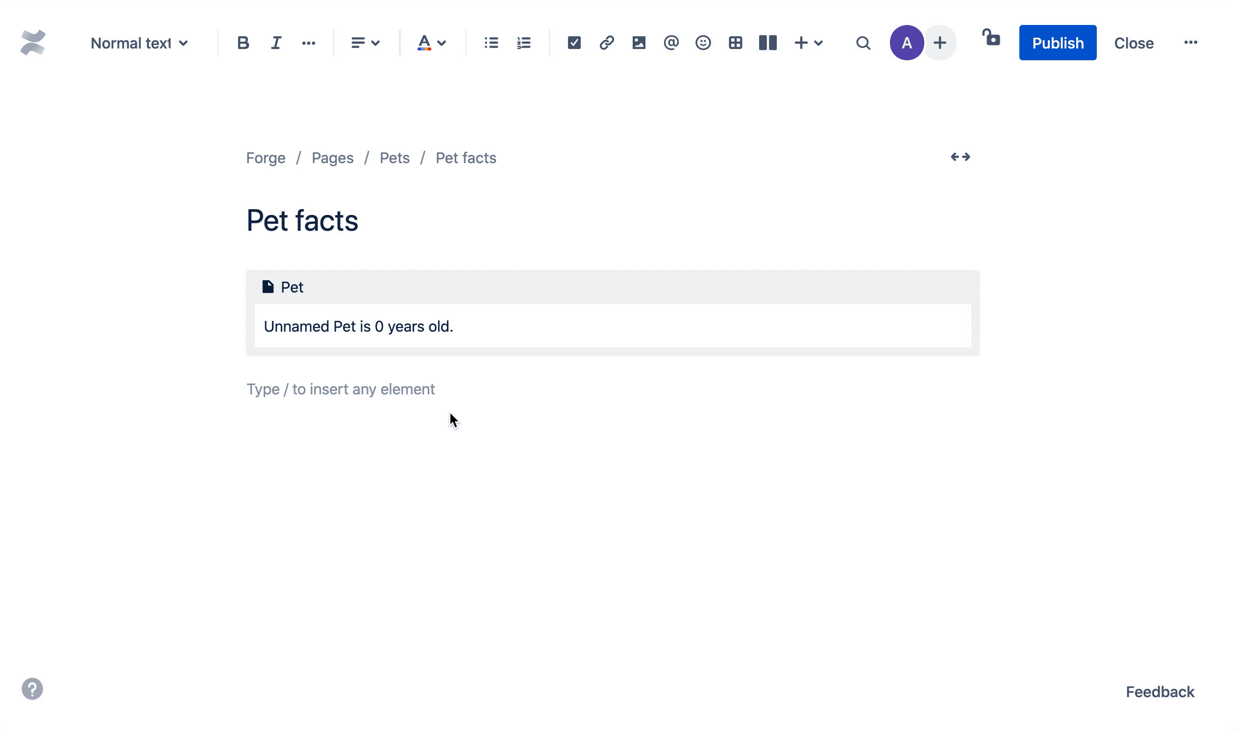

Add default pet configuration
In this example, by default, the macro displays Unnamed Pet is 0 years old.
Create a default configuration for the pet's name and age, and then add defaultConfig variable as a fallback in case config is not set.

Add dynamic input values for the pet's name and age.
Now that we have created configurations (name and age) for your macro, we can now enhance this feature to include dynamic input for the pet's name and age.
For example, if a user submits the name Fluffy and age 2, the macro displays Fluffy is 2 years old.

View your app
  1. Edit a Confluence page in your development site.
  2. Select Insert icon from the toolbar from the toolbar.
  3. Find the macro by name and select it. The app is displayed on the page.
  4. Click the pencil icon to open the app's config panel on the right side of the page.
  5. Type the Pet age, Pet name, and then close the configuration page. The config values are saved automatically.
You should now see the config values displayed within the app.
