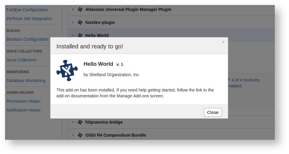

  8. Press Upload. The system takes a moment to upload and register your app. It displays the Installed and ready to go dialog when installation is complete. install success
  9. Click Close.
  10. Verify that your app appears in the list of User installed add-ons. For example, if you used Hello World for your app name, that name will appear in the list.
