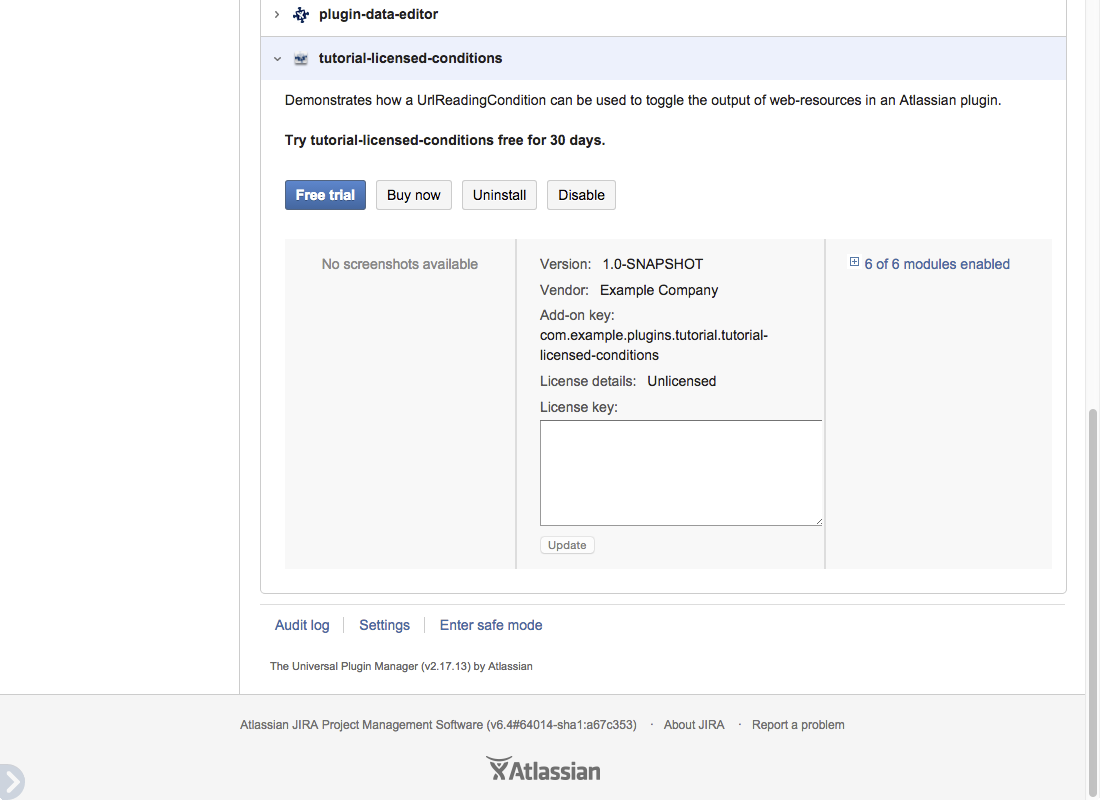

1. Verify that you can see your app listed in the UPM.

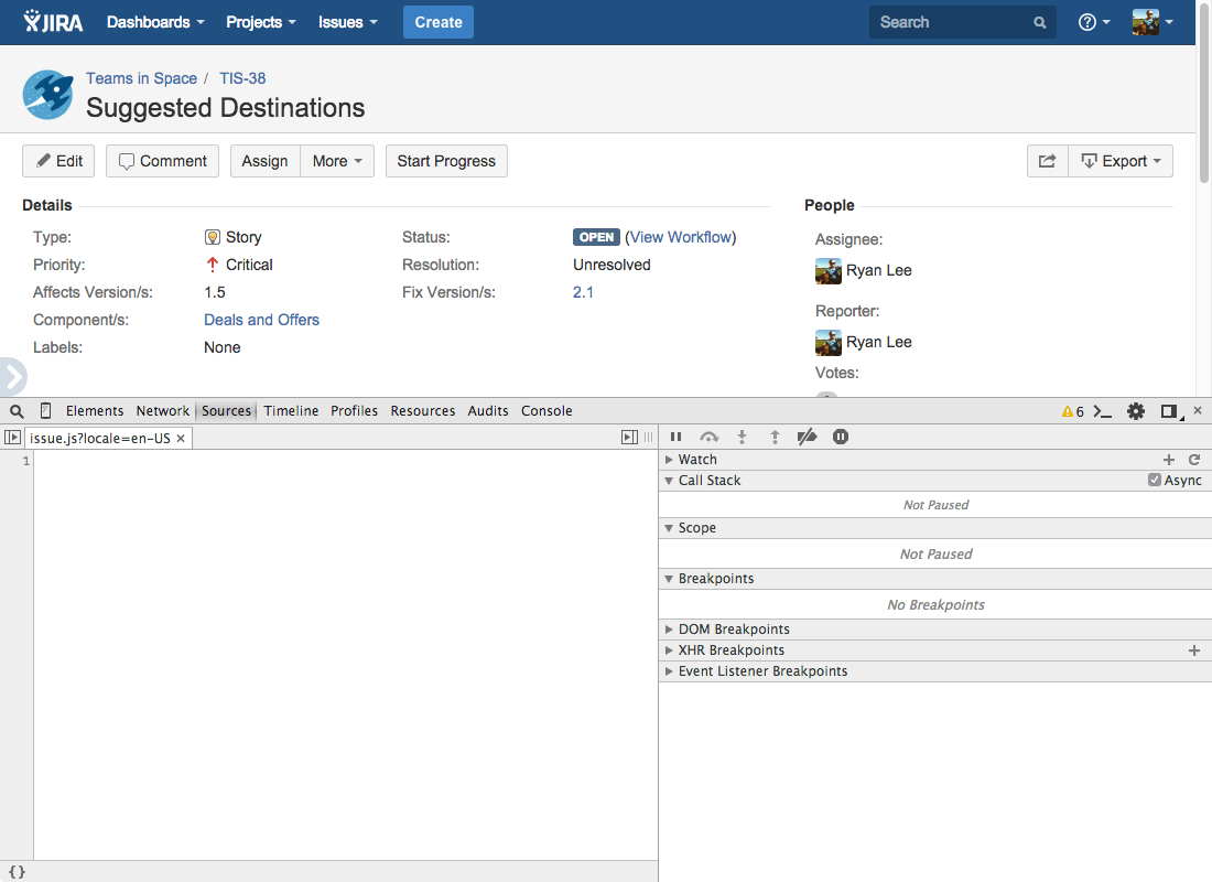

  9. Navigate to an issue page in Jira.
  10. Verify that the contents of the issue.css and issue.js files are output on the page, via your browser's console. At this point, since we're using atlas-run, they will be served as individual files.
    unconditional resource on viewissue
Your resource has now been added to the view work item page. However, note that the flag's message is inaccurate; the app is outputting the code irrespective of whether the app is licensed or not. Let's change that!

Check behavior in unlicensed state
To check the behavior in an unlicensed state:
  1. Navigate to the UPM in Jira and find your app.
  2. Edit the license key field, and remove the license.
  3. Click Update.
  4. Your app should now be "Unlicensed." UPM app unlicensed
  5. Navigate to an work item page in Jira.
  6. Verify that the contents of the issue.css and issue.js files are not output to the page, via your browser's console. The files should be empty. conditional resource no license
Great! Our web-resource contents aren't affecting the page when we are not licensed!

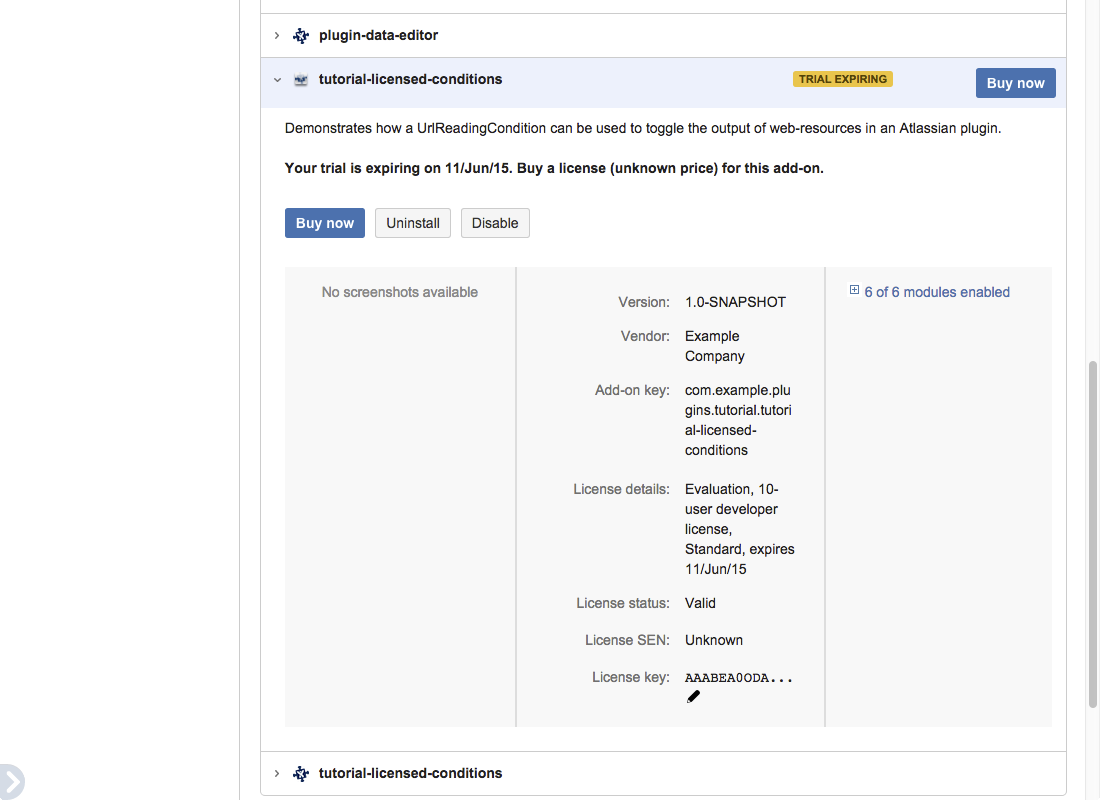

Add a license to the app
To add a license to the app:
  2. Enter the following in the License key field:
    1
    2
    AAABEA0ODAoPeNp9UE1Pg0AUvO+v2MSbCc0uQZOS7KEIUWMtpNJqGi9bfKUb4S3ZD7T/XgrqwYPv9
    mbezGTeRXn0NK8cZRHlPGZRHEW0SEsaMh6SFGxlVOeURlGCdbRRFaAFetCGdo2vFdI36KHRHRhLV
    r7dg8kPGztsgjNyY0Cexal0IELOw4DNA85J1svGj4xwxgOZrOzsciYrp3qY0Eep0AFKrCD77JQ5j
    TapN6PyNb5mw5Dc1BKVndwWrpHWKonkCUwP5j4Vye28DF422yh42O3ugoTxZ7KcagzsBt9Rf+AP8
    k/O90V56mAl24HPttkyL7L1b+1Etnut19BqB4sa0FkRXpHCm+ooLfz9wRfgrX9WMCwCFAkWHvhJC
    dutS3LcZ46iYgICDPQqAhQL76vdT4AYTQXBwl/wbw/MtQrP4w==X02dt
    This is a 60-second license key.
  3. Click Update.
  4. If accepted, a lozenge and a banner should appear to notify you that your app license expires soon: UPM app licensed with timebomb

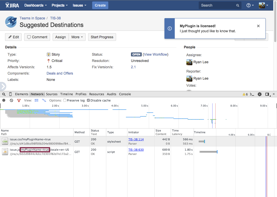

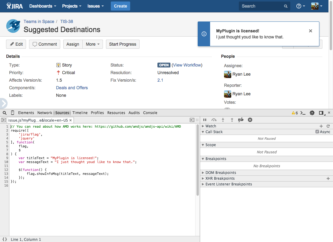

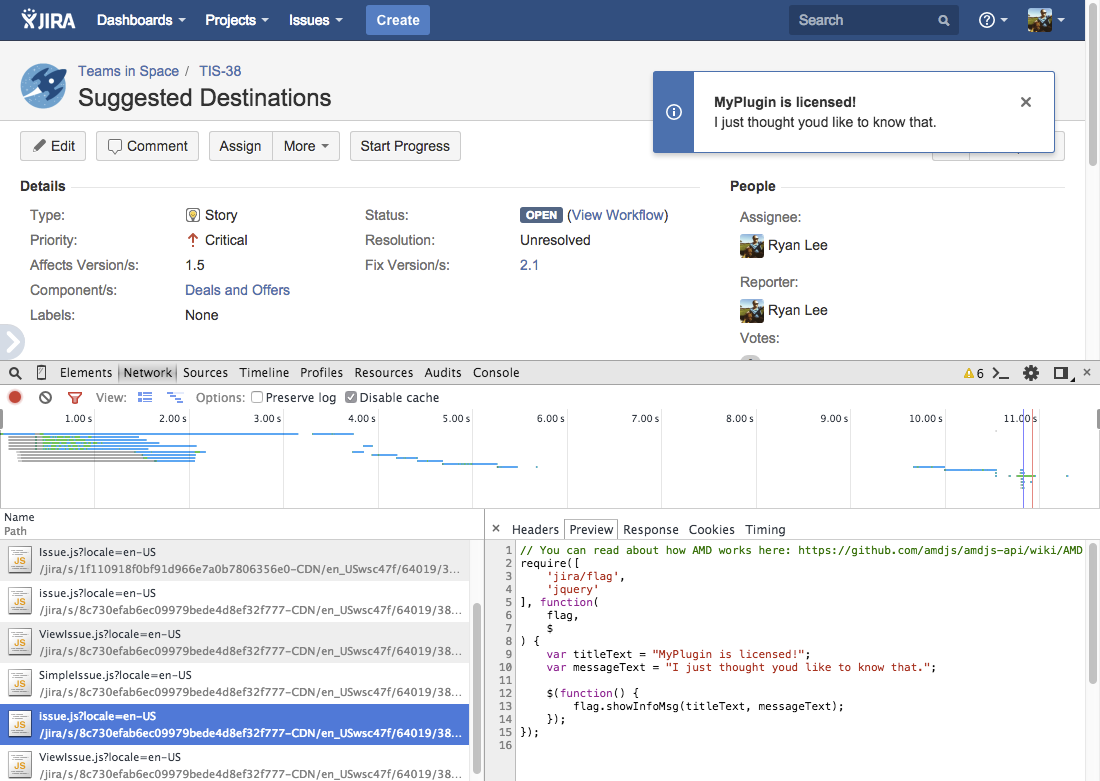

  5. Navigate to an work item page.
  6. Verify that the contents of the issue.css and issue.js files are output on the page, via your browser's console. At this point, since we're using atlas-run, they will be served as individual files.  conditional resource licensed source conditional resource licensed network
Your app will now omit web-resources when your app is unlicensed!
